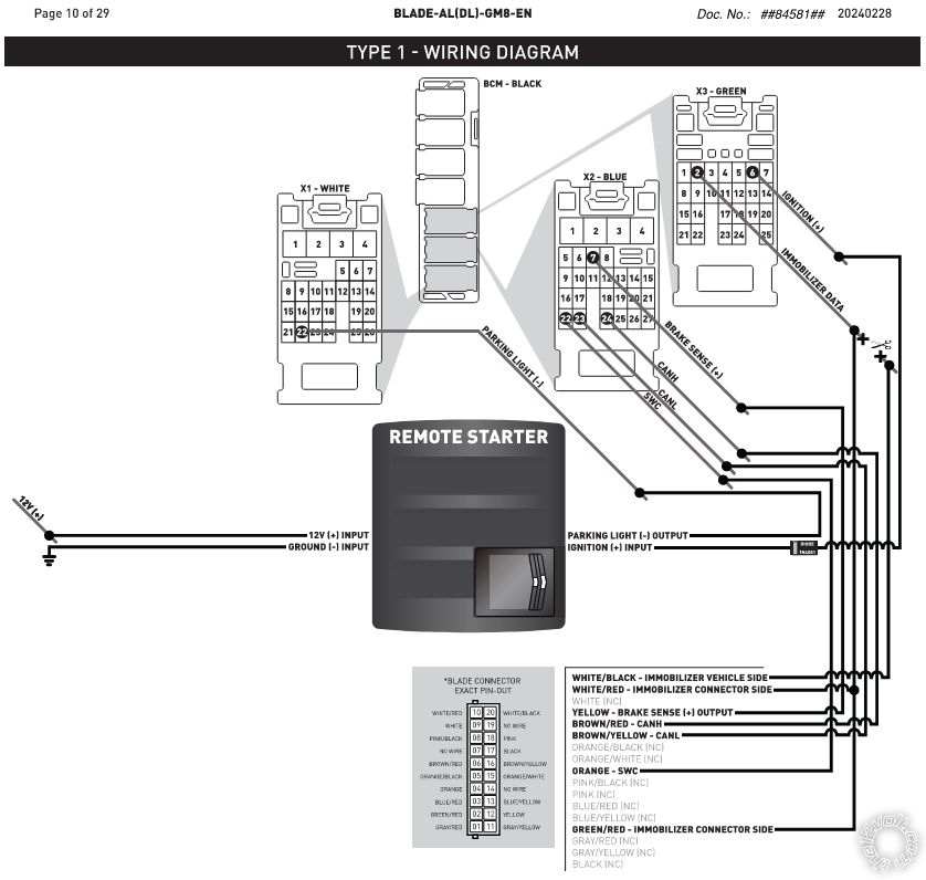

Not sure if putting the diagram for wiring that we used here will help or not.
Attached is the diagram from idatalink for Type 1, this is what we followed. When the 2 wires from the Blade Connector (white/red & green/red) are connected, the car does not recognize the factory key fob in the cup holder. I'm not sure if this is the reason we cannot get the car to talk to the controller.
2018 Chevrolet Equinox, Compustar 8920AS, Blade AL -- posted image.

I remember one that I had a real difficult time doing the programming on the Blade-AL. Bottom line I had had to fiddle around with the FOB to get it into the exact position in the cup holder/center console area to be seen by the vehicle and program the Blade-AL.
You might try a Blade Factory Reset first then get the FOB into a position where it will program the Blade-AL cartridge.
