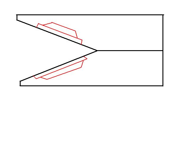

Posted: June 20, 2003 at 7:39 PM / IP Logged
Just an idea but here is a box from a side view i just cooked up box size - Page 2 -- posted image.
