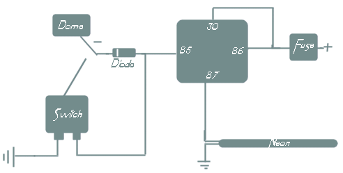

Okay im doing something similar, except my -12v is coming from my dome light so that when i open my doors, my neons go on. the question i have, is when i do this, will there be a way to put a switch somewhere so that i can turn them on when i want, like at night for driving around. and when the switch is off, i still want the relay to work, so that they come on when the door is open. I'm new to relays.. i fried a light already doing it with no relays. so i want to do it right this time.

Here ya go:
relay for neons in trunk -- posted image.
Notice the diode if you don't put it in your domelight will come on even if the door is closed and you turn the switch on so don't forget it. Any basic 1 amp diode should be fine. Hope that helps.

i have a problem, the lights go on and i dont need a diode. but when i push the button in/close door/ and the dome light goes off my second relay make a heavy
bzzzing noise, i dont know whats wrong. =o/

I was the guy that made up the wiring diagram that Steber posted. The reason the relay (on the right in the diagram) is buzzing is that the dome light gradually fades when the doors are closed, it doesn't go off instantly. Is there a way to have the relay switch quickly even though the voltage drops gradually? Would a diode across the coil help (doesn't seem like it would, but maybe)? relay for neons in trunk -- posted image.
