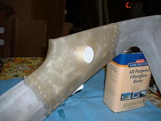

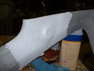

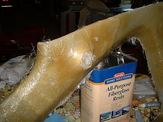

I just took on my first fiberglass interior project.  I want to do my dash and door panels but i figured id start with something small so i decided to mold a set of tweeters into my rear triangle window trim.  I just want to make sure im going about this the right way.  First i really roughed up the trim panel, then i mounted my tweeter bracket, then stretched some fabric over it and into the shape i wanted (actually i used an old pair of whity tighty's...they were real stretchy), then i resined over the fabric and let it harden good.  Then i layed a layer of glass over the whole thing.  Should one layer of glass on that trim panel be enough?  Because it doesnt have to be strong at all...its just holding  a tweeter.  I just got done glassing it and tomorrow im going to grind it down and put a thin layer of body filler over it and sand it down real smooth...so, is this pretty much the right track?  Ill post some pics later if anyones interested in what its gonna look like.

The procdure sounds right. Use one more layer of fiberglass for the project and it should be strong enough to handle the flex of the bondo sanding. If you only use one layer, the project will flex with bondo on it and will most likely crack the bondo and you will need to start over again with the bondo portion of the project.

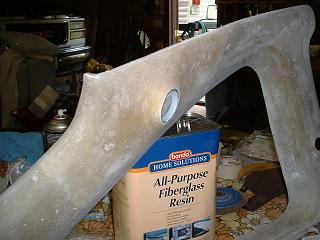

Well i've almost got one of the panels done...I've wet sanded with 600 and primed with filler primer about 4 or 5 times and I think i'm about ready for a coat of paint.  Here's some pics of what I got so far...

Looks great !!

For the sanding part...I started with real coarse 36 grit with a vibrating palm sander...then worked my way to 120 then 220 then wet sanding with 600. I did some by hand but i dont recommend it because it left a "wavy" look in it. I would suggest using a sanding block and only do those small curvy places by hand. I got one completely finished and ill post pics of the final install...
