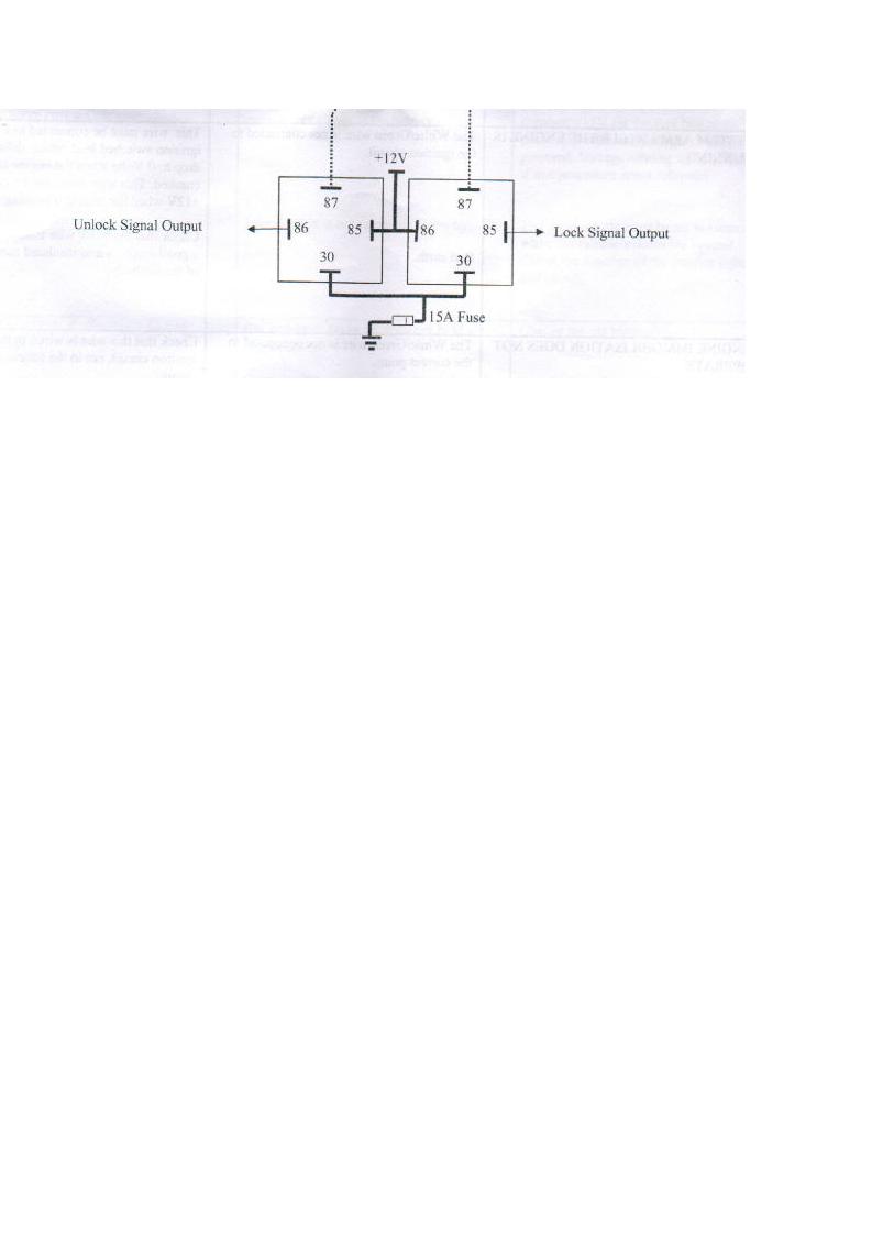

Fester
Joined: October 21, 2003
Posted: October 21, 2003 at 3:44 AM / IP Logged
This is how you would hook up an alarm to factory c / locking if you need it to be fluxuating i.e neither and rest or +12V?
I hope this helps?  It still maynot be what you need?
Central locking connection -- posted image.
- Fester
