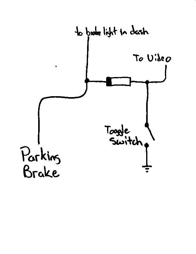

if you run the e-brake wire through a toggle sitch to ground, your ebrake light will probably stay on while you are driving. If this doesn't bother you then never mind. It would drive me crazy. You can still do that but I would suggest diode isolating a seperate ground through a toggle switch. something like this:
Video While Driving -- posted image.

Why would you do that? Maybe I should of Clarified what I said, just run the e-brake wire from the radio through a toggle switch, I assumed we would have understood that we were talking about the radio's wiring and not the car's. You never hook it up to the car's e-brake wire, therefore the light never turns on.

The reason I suggested integrating the parking brake into the circuit is so that he will be able to demonstrate to a police officer, should he be pulled over, that the video function of the unit will only operate with the parking brake on. Obviously this isn't neccessary but it would be nice.
