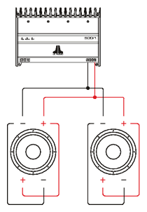

#2: What are my wiring options for the dual 8 ohm vc's is has?
i have a 300rmsx1 at 2ohm on my amp i would like to use that
If my amp will not work for one.  I would want to get a better amp and have two.
please help me on that, and how to wire up.

kenwood 600watt 2 channel.  im powering two series 1 rockfords on it at 4 ohm.  Bridges to 300rms, i know its not exactly 300 on 12volt system.
Just wondering if its possible to wire the sub to 2 ohm with the dual 8 ohm vc's so i can get that power.

OH, I misunderstood your question.  To get 2 ohms with two 8 ohm DVC subs, wire each sub with the VCs in parallel (which makes 4 ohms per sub) and then wire each of these in parallel to the amp.  This will put all 4 voice coils in parallel, and give you 2 ohms load on your amp.   Like this:
Shiva Questions -- posted image.
Your kenwood amp must be able to handle this: it must be 1 ohm stable in stereo to make this work.

i dont have these subs yet.. i was just wondering it the kenwood can take it bridged..the kenwood isnt 1 ohm stereo stable i know that for sure.
I think ill just stick with the rockfords till i make a box for my MB quarts and have them running the same power. The SQ would be better.
