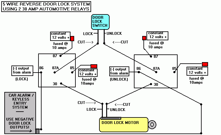

I wired it up like the five wire alternating pulse and all it does is pop fuses. Why? Any ideas? Please help. Thanks in advance.
padawan
Copper - Posts: 215
Joined: June 11, 2002
Posted: November 03, 2003 at 6:53 AM / IP Logged
Well if it came equipped with factory keyless then it's not 5-wire reverse, it's negative (type B), for nega tive, u would have to reconnect the car's lock and unlock wires, and then just tap into them using ur alarm's lock and unlock wires...
Are your sure you installed the 5-wire reverse right?
look at this:
1993 Ford Thunderbird Alarm info -- posted image.

Tried wiring like the diagram but no luck. What could my problem be. Please help. Thanks in advance! Jeff do you have a clearer picture? When I tried to click on the 5 wire link it comes out too small to read. Thanks.

Thanks for the picture Jeff. I have not tried that wiring yet. If one of the switch's is broke will this make the whole lock/unlock not work? Thanks in advance!
