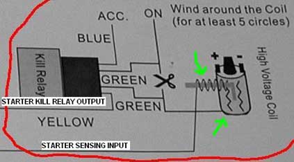

hi, I'm trying to install an remote auto start to Chevy Prizm Lsi 1998. In the diagram that i get from the product, there is one Coil says "High Voltage Coil", and it also says "Wind around the coil for at least 5 circles) for the kill relay.
Where can I find the coil, and which part of the coil should i wind the wire to?

hi, I'm trying to install remote start to Chevy Prizm 1998, but I don't undertand about the Starter kill. I also include the picture from the diagram. which one is the tachometer wire? the starter kill relay output or starter sensing input? and this two wire like shown in the diagram attach to two different place of the coil. And I try to find the wiring diagram from the car, it only tell the tach wire. So what kind of wire is the buttom of the coil and what kind of wire is the one that has to be winded at least 5 circle, and I don't understand where should i wind the wire too.
Please help If anybody know about this diagram. What happen if I didn't connect the starter kill, can i still start the car with remote? what about others thing like alarm, turn on the heater and everything?

that diagram os confusing and i have been doing this for years... here is how to do a starter kill... take the trigger from the alarm and connect it to pin 86 take pin 85 to ignition 1 (hot in the crank) cut the starter wire and put one end to 87a and one end to pin 30. it does not matter which cause it is basically only a switch. there are a few ways to wire a starter killl but this is probably going to be the easiest for you. As for your tach signal go to a coil pack if you can. check the vehicle wiring section of the site for other tach wires. hope this helps
