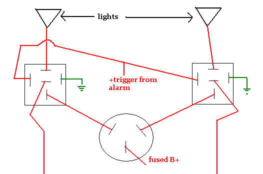

how about something like this?
Alternating flashing lights? -- posted image.
excuse my drawing skills.

oh, the round thing is a signal flasher

That is a real good drawing, but I don't have an alarm trigger (this could be a toggle swithc though I think) and it looks like the lights would flash at the same time like hazard lights.
What I need is for them to flash at different times, back and forth?
Let me know if this sounds right?
