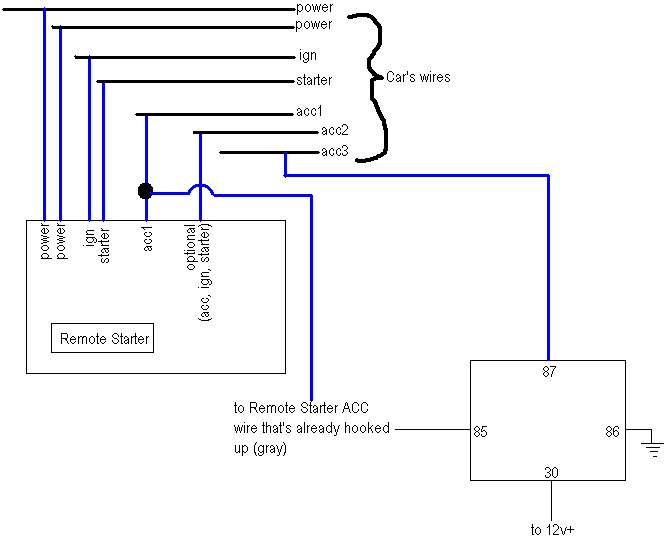

Ok, I realize I did something wrong, but I'm not sure how to rewire it.
I installed a Crimestopper 900 VI keyless entry/remote start module into a '93 Ford Taurus. The Taurus has 3 accessory wires that I believe need to be powered (I used to have an older bulldog module in this car, and I connected 1 acc wire from the car to 1 acc wire from the RS, and 2 other acc wires from the car to 1 ign wire from the RS, and it worked fine).
This time, I thought I would use a relay to power the 3rd ACC wire. What happens now is that the blower can turn on when the car is off, so I guess my relay configuration is wrong Taurus remote starter:  blower stays on -- posted image. Here's how I did it:

On pin 86 of the relay, do not use ground rather use the GROUND OUT WHEN RUNNING wire ( YELLOW/BLACK ) wire

Thanks Jeff! I kept looking at the 12v+ as the problem, but I never thought about the ground signal!
You see how that yellow/black wire is programmable either as a negative ignition output, or for the anti-grind/starter disable? Well, I hooked it up as it shows for the second option (starter disable). Can I still tap that same yellow/black wire for this other relay to power the extra accessory wire? I guess in a way I'm wiring it like the second option, but using it for both.

I guess I meant to say that I needed it for an extra ACC wire, not IGN, but I'm guessing it's similar anyway. So I guess if I program it for the second option (starter disable), and then wire it for both the starter disable AND to power up the 3rd ACC wire, then that yellow/black wire will still act as I need it to. In other words, it doesn't look like the yellow/black wire acts much differently, whether you program it for the first or second option.

Program it for (-) ignition output which is esentially a ground out when running. IF you want an extra ACC wire, you can use this relay diagram, if you don't have another (-) trigger wire or don't feel like splitting the YELLOW/BLACK wire.

If I program it for (-) ignition output to power the 3rd ACC wire, can I still use it for starter kill/anti-grind....because it won't activate when locking the button anymore? Or do I just have to forget about that feature?

ACC and IGN are essentially the same.
You could leave the Starter Disable and use IGN 2 for that other wire.
It can't do Starter Disable and (-) IGN at the same time.
