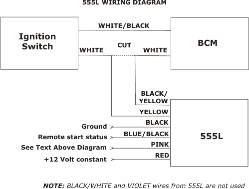

aside from this, the rest of the install is actually fairly easy since most of the wires you'd need to find for security is at the bcm which is part of the fuse box too.
tach is white or orange at pin b or g at igntion control module on the top left of the engine, next to the oil fill cap.
good luck
