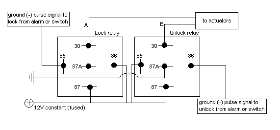

adding door lock actuators, help -- posted image.
Sandungero24
Member - Posts: 44
Joined: February 24, 2004
Posted: February 25, 2004 at 6:00 PM / IP Logged
this diagram only applies if the "trigger" wires from the alarm provide a pulsed ground (-) to lock/unlock. If they provide a pulsed positive (+) instead, you will have to ground the opposite 85/86 terminal to allow the relay to work. Actually, my alarm allowed me to use either pulsed (-) or (+), I just chose to use the (-).
