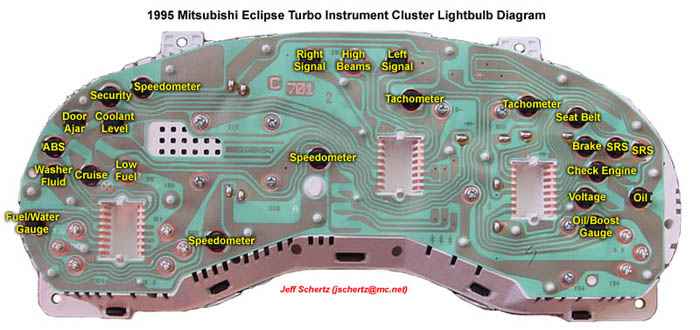

I took out the dash, it has three rectangular connectors with about 14 connectors each, with 7 at each side, that lead to left, center and right. There is a white cable but is not white solid, it has a silver line across.
Innotek Remote start / Mitsu Eclipse GS-T -- posted image.
vhmc_falcon
Joined: March 03, 2004
Location: Paraguay
Posted: March 15, 2004 at 11:20 AM / IP Logged
Unfortunately behind behind the tach there seems to be a signal convertor of some kind.
