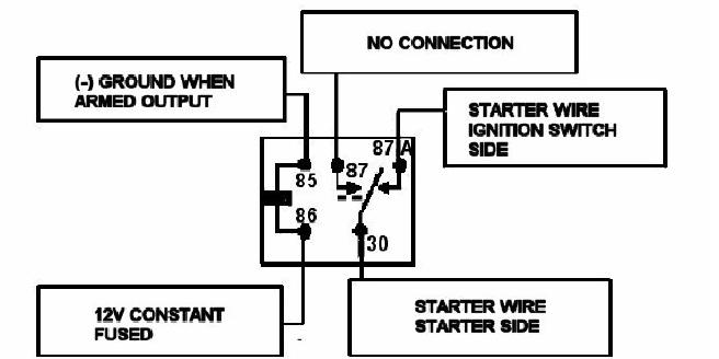

Does anyone know what to do with this wire. Its organe coming from the alarm brain and its orange and it says -NEG armed output Starter disable. Now what do I do with it do I just ground it or what?

Hook it up to trigger a starter kill relay.

you would cut the starter wire into two and one side will come from the key and one will come from teh starter.

Also, pin 86 is wrong. It should be 12 volt ignition. You actually can use a constant to wire it up, but in the past I've found that this causes dead batteries. Its much more reliable to wire it to an ignition wire, but make sure its an ignition wire that is hot during engine cranking also, or the relay wont work right.
