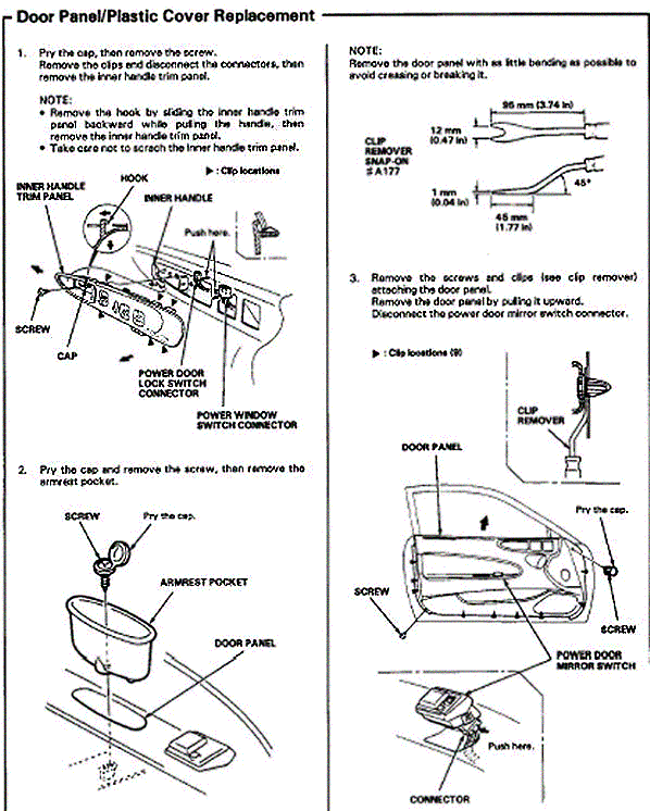

Its an EX I think. Do you mean the grill when you say speaker cover or what? door_panel_removal.gif Is this diagram accurate then, that I found also? It's a little confusing.

Yes.  Some of them just pop off and some have three or four screws.  The EX I think has screws.

Ok, last question, is this diagram accurate then? 4E8_door_panel_removal.GIF (its a little blurry). Thanks for all your help so far!

Oh yea, I forgot about the hidden screw in the armrest pocket.  But that image looks pretty good to me.
