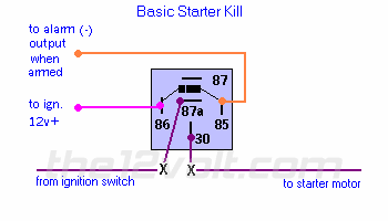

starter kill relay:
1994 Explorer, Kicx alarm -- posted image.

Using the above diagram, can you please tell me what wire goes to which post on the relay for a 94 Explorer. I have 86 going to the yellow 12V+ at the steering column, 85 going to the (-) alarm output, 87a to the RED / lt blue wire closest to the switch, and 30 to the RED / lt blue wire leading away from the switch. This configuration however doesn't prevent the car from being started when the alarm is armed. Therefore something is obviously wrong.

you cut the starter wire in two and connect them each end to 30 and 87a.

Yeah, I did that as you can see from my previous post and it isn't working so therefore it must be wrong, I need to know the correct positioning of the wires and if I even have the correct colored wire for my year/make/model vehicle. Maybe I guess i just inhaled a larger dose of that Hydrogen and stupidity than most others.
