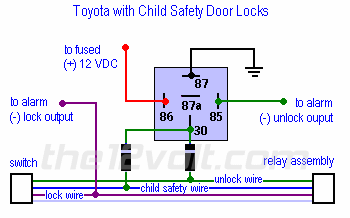

Door LockLight Green (-) Power Lock Module, Driver's Kick, connect RED / Green
Door UnlockDark Green (-) To Dark Green if Vehicle has Child Safety
I found the above info on this website. Can somebody please help me with it.
1) Door lock: What is meant by connect RED / green? Is the lock wire Light green in color in the power lock module?
2)Door unlock: How to check if the vehicle has child safety? Where can i find the dark green wire?
Please help. Any help will be much appreciated.

Toyota Camry Door Lock -- posted image.

Does that mean that I need to use a relay or can it be done without one?

I think you need the relay to supply a better ground from #87 instead of the alarm output.
I recently installed a remote start on a Toyota and this setup works fine.
You can get the parts here: http://www.partsexpress.com/webpage.cfm?&DID=7&WebPage_ID=3
