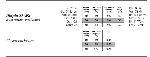

Parameters:

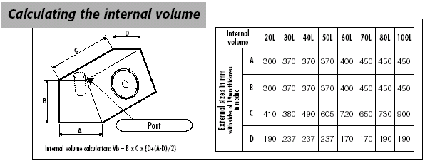

I built a closed enclosure and used the 40L recommendation to build my box. When I tested this speaker on my home system, the sound was amazingy improved; I could hear the difference. In the car it is a different story(and different amp).
