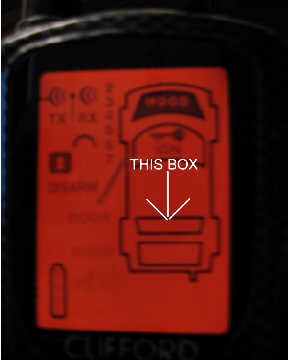

sroth140 is right. the blue wire on the main harness is labeled "multiplexed trigger input" in the install guide. it says that it is commony used for the trunk. the grey wire on one of the smaller harnesses is strictly labeled "hood pinswitch shutdown wire.". i checked my new remote, and your right. it goes from 2 - 7. zone 1 is for the shock sensor and it is seperated into this box. 1 & 2. 1 is for the blue wire on the shock sensor. and green is for an extra sensor (sold seperately, such as a motion sensor). Viper 791 Hood -- posted image.anyway, if you hold down the unlock button, lock button, trunk button, and the aux button on the remote all at the same time, your remote goes into programming. press the TRUNK button to select between trunk, hood, neither, or trunk and hood. don't press anything for about 5 sec and remote will exit programming. follow this link, and i have a short movie of how to do it. it's about 26 seconds long. you don't have to press all of these buttons, but i did them all. remote link
