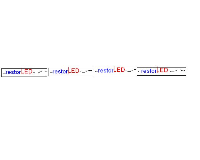

ok wow i have posted this 3 times and every time it messes up and canot be read for some reasion, ne way this is what i want to do i want to put 10 or so LED's in my car to give it some light (my lights are brokwn) and i have a bunch of 470  ohm resistors  and i was wondering what is hte best way to wire theys  or what you would that is farily easy, thanks alot!!!!!!!!!!!!!!!!!!!!!!
(theos are the LED's i cant paist the table because it messes up each time)

how many are you installing?
if you are installing a few the simpliest way to explain would just take each LED, attach a resistor in series with it, and wire each one of those to +12V
you can get into series/parallel but for that sake of simplicity im not gonna bother explaining that unless you are using like 5 or more..
ohh just reread your original post... 10... you can still do as said above...

so...err take 10 seprate lines fro mmy battrie ane put a led on each one ... 10 lines?(power lines)
xetmes
Silver - Posts: 586
Joined: May 18, 2003
Posted: July 31, 2004 at 7:31 AM / IP Logged
nah you dont have to do that, they only draw 20mA, so 10 of them will only draw 200mA about that of a relay
just use one power wire that branches to the 10 LED/resistor combos
imagine there are 10 sets of resistor/LEDs in between the little "o" s, sorry for the horrible drawing lol
POWER--------------------o------------\/\/\/\----- >|-------------------o-------------GND

Posted: July 31, 2004 at 1:52 PM / IP Logged
ok humm so they are all jsut like on the same wire? like in the picture ??? kinda except more leds LED’s in my car -- posted image.
