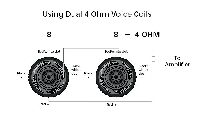

If these are dual 4ohm voice coils here is an example of "series-parallel". This shows kicker subs but just use the "white dots" example to distiguish the voice coils.Voice coils are in series, then subs in parallel.

Also you don't want to run anymore than 300W rms to those sony subs if you plan to keep them for long.

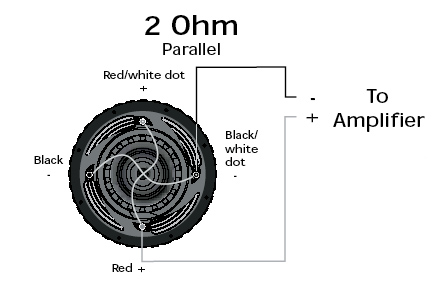

I have 2 Kicker CompVR 4ohm DVC's wired like that now, but if you get an amp that's 2ohm stable in stereo simply wire each sub like this.
