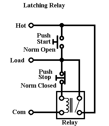

I'm wiring a bike for a friend, he's fitted monentary switches in the handle bars and i need to get a latched output from them. i purchased latching relays but cannot figure out how to wire these so that one push = on the next = off!
unfortunately the only relays i could get hold of are twin coil latching relays, one coil on, one coil off, can anybody think of a way these could be used in a simple circuit so that the same button is used for on and off? maybe using another relay alongside?
i have seen the circuit using four or five relays, if i have to go this way i will, but that will mean i'll have to find room for a minimum of twenty!!! relays.

hotwaterwizard
Silver - Posts: 1,350
Joined: December 11, 2003
Posted: September 02, 2004 at 11:50 PM / IP Logged
latcing relays -- posted image.
Here is a circuit with a Standard Relay

hotwaterwizard
Posted: September 08, 2004 at 7:28 AM / IP Logged
Here is a Latching Relay using a Standard Cube Relay.

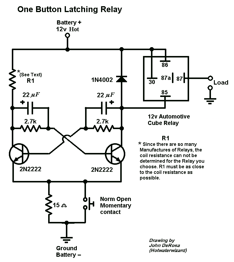

Hi john thanks for the reply, the problem i have is the bike is already fitted with 5 momentary contact switches in the handlebars, it's not possible to fit more. This is going to be a 'show' bike and has to look just so, i have brought some miniature relays cos i've got to be able to turn things on and off with the same switch! so it looks like i'm going to need 20 relays in a box, arranged in sets of four as shown in the latching circuit elsewhere on this site!

Let me see if I can wirk out a smaller version for you.  You could use a circuit instead of all of those Relays.

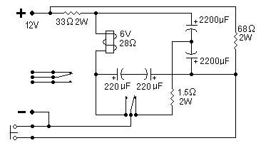

hotwaterwizard
Posted: September 08, 2004 at 6:35 PM / IP Logged
Here is a sample Circuit that uses a 6v relay to operate 12v with one button.

hotwaterwizard
Posted: September 08, 2004 at 9:24 PM / IP Logged
Here is a Circuit I just Made for you.

ashbyspannerman
Member - Posts: 18
Joined: August 22, 2004
Posted: September 09, 2004 at 4:19 AM / IP Logged
Thanks again John! i'll be off to my local electrical store and pick up the bits today!!!!
