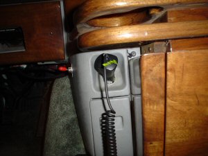

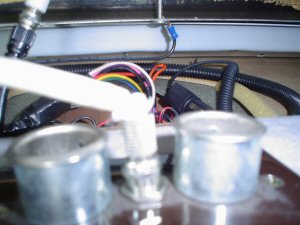

chrisbee
Joined: August 31, 2004
Posted: September 06, 2004 at 12:22 PM / IP Logged
I truly appreciate all of the responses.
The cig lighter is in the dash area as indicated by the picture.  It has a cell charger connected to it.   Now the other two cig connections are above my head in a cabinet.   They are not connected to the main cig lighter at all from what I can tell.  The pic to the right is above my head.
