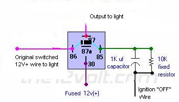

Goal = Interior lamp on until start'n car -- posted image.
I'm a newbie to all this, so work with me.  Would this work, or am I WAY off?
sm951
Member - Posts: 25
Joined: October 08, 2003
Posted: September 17, 2004 at 8:59 AM / IP Logged
Man, I just realized that diagram is WAY off.  Goal = Interior lamp on until start'n car -- posted image.
Does anyone have a proven diagram?  Thanks again...

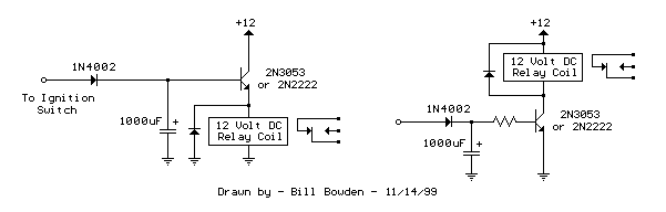

hotwaterwizard
Silver - Posts: 1,350
Joined: December 11, 2003
Posted: September 18, 2004 at 10:31 PM / IP Logged
Here is one.

sm951
Member - Posts: 25
Posted: September 19, 2004 at 1:03 AM / IP Logged
hotwaterwizard wrote:
Here is one.
Thanks!  But since I'm EE illiterate, could you please explain the elements of the diagrams in terms of a SPDT relay pinout - where they go and what they are?  Thanks again...

You will need a Soldering Iron.

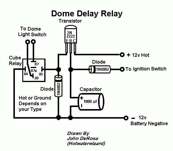

hotwaterwizard
Posted: September 19, 2004 at 1:40 PM / IP Logged
On second Thought here is an easier way to tie it in.Goal = Interior lamp on until start'n car -- posted image.

sm951
Member - Posts: 25
Posted: September 20, 2004 at 9:14 PM / IP Logged
Thanks John!
A couple of questions:
-what will energize the relay to give continuity between pins 87 and 30?
-and I'm guessing if the ignition switch isn't in the "OFF" position, the capacitor will not get charged up?
hotwaterwizard
Posted: September 20, 2004 at 10:11 PM / IP Logged
The Transistor conducts and sends a voltage to the Relay.
 As the capacitor discharges thru the Diode on pin 85 it slowly looses voltage until the Transistor finaly turns off and the Relay in turn shuts off too.
