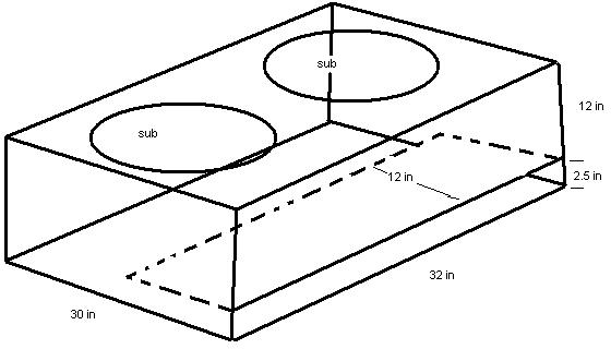

hey guys, im gonna be running 2 15 DVC 6ohm subs. im woindering how i should wire these in order to produce the most wattage going ot each. my amp is ma audio hk1397 specs are :
2 x 400W RMS @ 4 Ohm Stereo
2 x 700W RMS @ 2 Ohm Stereo
1 x 1600W RMS @ 4 Ohm Mono
someone told me that this could run at 1.5ohm... if i run at 6 ohm will they sound really bad and not much bass?
you think this thing will run at 1.5 ohm? also, im building a ported box  and i dono if i should add the recomended cubic foot values for each sub to create a box double the size, or just use the values for one sub for both?

i have 8 connections on each subwoofer heres a diagram how i have it hooked up right now, i haev a box built too but it sounds REAL bad 6 ohm dual coil -- posted image.
