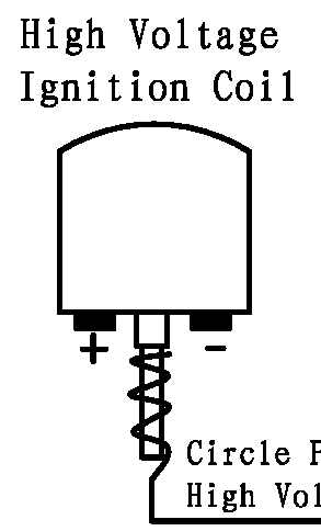

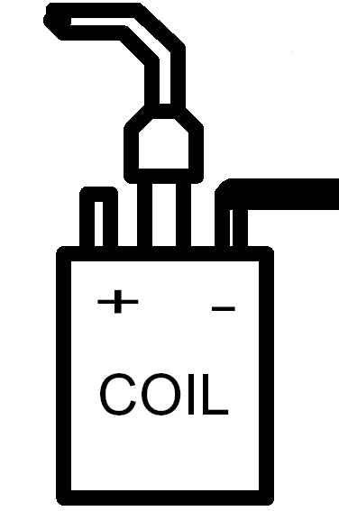

I am not really know how to hook up the tach sensor wire for remote starter.
I read many remote starter's manual. There are 2 ways for detecting the tach as below.
How to hook tach sensor wire? -- posted image.
For example, PONTIAC TRANSPORT 1990-1993
TACH SENSORWHITE at IGNITION COIL MODULE
Which detecting way is better? Connect it drectly or just round 10 loops on it?
I am new installer. Sorry for asking so stupid questions.

WAY 1:
WAY2:

R U using the WRAP around Plug or coil method or can U use a direct TACH connection?
U can also hook it up here:
Tach SignalWHITEIGNITION MODULE OR AT E.C.M./P.C.M. *
* Base Models Are Throttle Body Injected
also
1992 - 1993  3.1L  Passenger Dash Black 32 Pin connector, Position D-4
1992 - 1993  3.1L  Passenger Dash Black 32 Pin connector at PCM, Position C-9

I work for a company selling a lot of alarms. So there are many ways to detect the engine starting. But whatever, just give above 4V to that wire on alarm when engine is starting, it will work well. But just not really know which way is the best. For some vehicles, round 5 loops is not working though the manual says it does.
Some alarm's manual says it should connect to engine oil pressure sensor. But it is hard to locate the engine oil pressure sensor wire. Most vehicle's installation wiring sheet only provides the "TACH SENSOR" wire. For this case, mostly, I connect it directly to the tach wire, it works well. Isn't high volt? But the alarm didn't burn. Why? But if I round 10 loops on the tach wire, it wouldn't work. Why?
