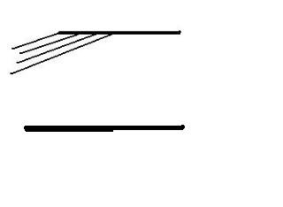

175 watts X 4 = 700 watts total.  Into a 2 ohm load, the most amperage the final wire will see is 18 amps ( https://www.the12volt.com/ohm/page2.asp#current) and 16 gauge will carry up to 15 amps;  14 ga. will handle up to 25 amps ( https://www.the12volt.com/info/recwirsz.asp)
Soldering four 16's to a 14 shouldn't be too much to heat with a good 100 watt soldering iron.  But it would be easier to solder them on one at a time.  Electrical tape would work best, tape each joint and then retape over the whole length of joints.  Illustrated here:
Pick up a wire loom at the hardware store to cover all the tape and give a nice finished appearance.
Barrier Question -- posted image.

thanks for clarifying that stevdart. do you use a 'wire slitter' to remove insulation mid-wire?
and example of one is here:
http://www.partsexpress.com/pe/pshowdetl.cfm?&DID=7&Partnumber=360-720
stevdart
Platinum - Posts: 5,816
Joined: January 24, 2004
Posted: October 08, 2004 at 10:53 AM / IP Logged
Cut through the insulation about a quarter inch apart with a wire stripper, using the hole that corresponds to the wire gauge.  Then slit the insulation in that spot with a sharp razor blade, and peel off the insulation.  If you cut carefully, you can do everything with a sharp razor blade.  But a wire stripper is good to have.
