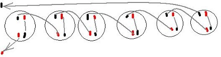

I'll cover the DVC part, but I'll leave the quads alone because I've never dealt with those.  This is just for the six 6-ohm drivers, but the same rationale follows for other impedances.  To get the highest possible load, wire in series/series.  A wire from the pos on the amp goes to the first woofer, coil one pos.  Coil one neg goes to coil two pos, then coil two neg goes to the second woofer coil one pos.  And so on, until the last terminal goes back to the amp neg.
wiring dual voice coils specialty -- posted image.
Everything is added up.  Each woofer has 12 ohms (coils in series), and there are 6 woofers in series.  12 X 6 = 72 ohms, the highest load.

So  is positive to negative series ? What does that do to the ohm load?
What does parallel ohm load do?
I think if you got 1 dual 4 ohms and you series it u get 2ohms, and if you parallel it you get eight... Equation is GOLDEN... thx

You have it backwards.  If you place the coils in series you get 8, in parallel you get 2.
Think of it like water.  In series, all the water must flow through both coils (pipes) so the water must flow twice as far.  In parallel,  the water can flow through both pipes at the same time, so half goes through the first and half flows through the second.  Make sense?

The equation for parallel wiring is 1/Rtotal = 1/R1 + 1/R2 + 1/R3 etc ...  Thye equation for series wiring is Rtotal = R1 + R2 + R3 etc...
Quads are no different from any other speaker.  It's just that each speaker has four voice coils to include rather than one or two.  It is nothing special, you simply have to know Ohms Law.  Check out the info on the left side of this site, including the Series/Parallel calculator.
