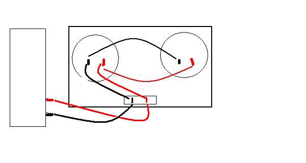

i think he was trying to say to wire them like this
Not sure how to wire up amp and subs -- posted image.
You will need two terminal cups. You wire the subs like normal to each terminal cup. Run a wire from one terminal to the other terminal, do the same for the negative. Then you want to add ONE from the positive end of the amp to the positive wire running to the terminal cups. do the same for the negative. hope that helps

Subs are usually wired to each other when you are doing parallel wiring.  It's the same as wiring each sub separately.  You need only one terminal plate on the box.
