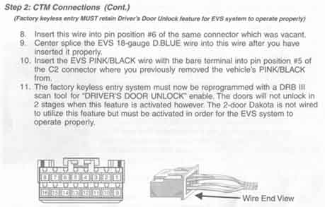

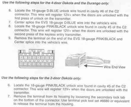

I'll post some scans of the instructions i got. I got the mopar EVS II. its what the dealer would install if you went back to them. It says
 " For 2-door Dakota only:
.........  6.   Locate the 18-gauge PINK/BLACK unlock wire found in cavity #5 of the connecter.   7. Insert this wire into pin position #6 of the same connecter which is vacant."
"for 4-door Dakota and Durango only:
6.  locate the 18-gauge D.Blue unlock wire found in cavity #6   7. center splice the EVS D.Blue wire in.    8. Locate the pink and black wire in cavity #5.  9. Center splice pink and black wire in."
I have a 2-door modle but I have the D.Blue wire in cavity #6 that should not be there. should i use the 4-door instructions or do i need new instructions?

Regular cab dakota has 4 door wireing -- posted image.Regular cab dakota has 4 door wireing -- posted image.

The 2004 factory service manual shows no difference in the wiring for the CTM connector "C2"  for a 2 dr versus 4 dr.
