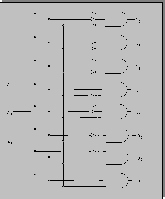

Could you use 3 seperate buttons instead of 2?
Then we could use a Decimal decoder.Three Pulses converted to one pulse -- posted image.
