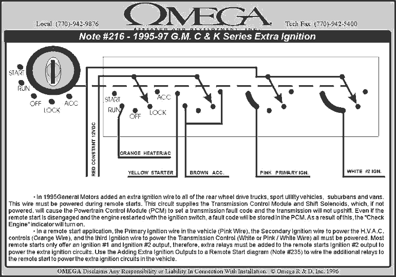

the remote start is not working, the truck starts, but dies right away... we found this information for the alarm:
Stoopid Question -- posted image.

I am banking on a problem with the passlock, either the module is defective, not installed properly, or just not installed. Did you use a bypass module?
