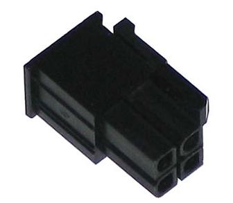

I tried that one already. I am a computer technician so I had the screwdriver out as soon as there wasn't a pinout in the owners manual. The connection is a standard 4 pin molex (Like in a power supply for a Pentium 4 computer).
power connector pinout question -- posted image.

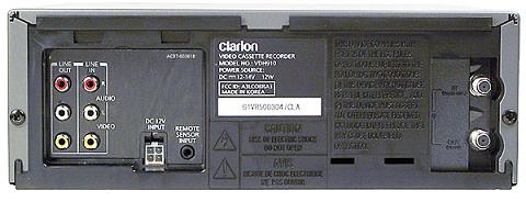

The back of the vcr looks exactly like this clarion power connector pinout question -- posted image.
Thanks for the suggestion though, I am open to them all.
