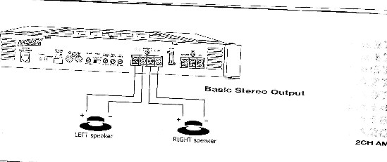

First i made a mistake I'm using a Legacy 1470 not 1870. I currently have it wired like this:
Amp Turning Off -- posted image.

well from that I would say possible bad ground,    have you actually looked at the amp when it cuts out, try to get it to cut out while looking at the amp, this will tell if its going into protection, or shutting off...Either could be a bad ground, you could have a bad remote wire.    you could have wire on one of the speakers touching the basket or each other,   any of which would cause trouble    look for these and let us know

It goes into protection mode so I will try and change the ground and check the speaker wiring.
