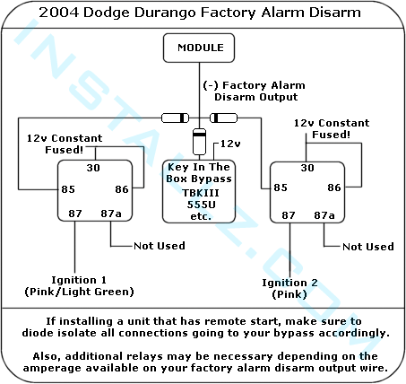

Posted: November 19, 2004 at 5:40 PM / IP Logged
Has anyone figured out how to disarm the factory alarm.  When I use the aftermarket alarm to arm the system, the factory alarm senses the door locking and arms the factory alarm.  I wish I had access to DEI tech, or Alldata.  If anyone has any ideas, or even guesses, I'd love to hear them.

Posted: November 19, 2004 at 5:48 PM / IP Logged
2004 durango disarm -- posted image.

Posted: November 19, 2004 at 5:56 PM / IP Logged
Your other options are to sell them a stand alone remote start that doesn't have keyless, an OEM add-on remote start system, OR hack up the factory key and solder wires onto the keyless circuit board inside the key for unlock. Use a relay that activates when you hit unlock, which would cause 87 & 30 to be common and activate the unlock on the factory keyless. Your basically just simulating pushing a button. Only issue is when the battery in the OEM key dies they will need for it to be replaced.. Good luck,

Posted: November 20, 2004 at 12:18 AM / IP Logged
TRY DOUBLE PULSING YOUR UNLOCK OUTPUT FROM THE ALARM
