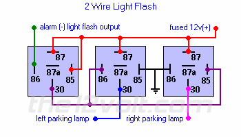

light flash on classic car -- posted image., what about something like this, and change the fused 12v to the alarm light flash +, and have it go to the left and right directional circuits instead??

Ok I found the power wire off my light switch, and the lead wire fro the front park lamp, now there is a one common wire off the light switch that goes to all the rear brake lights. Now the lights are all wired in series and actually ground to the sockets so can I run a lead off of the park lamp trigger wire and use a diode to connect to the rear brake light lead??
