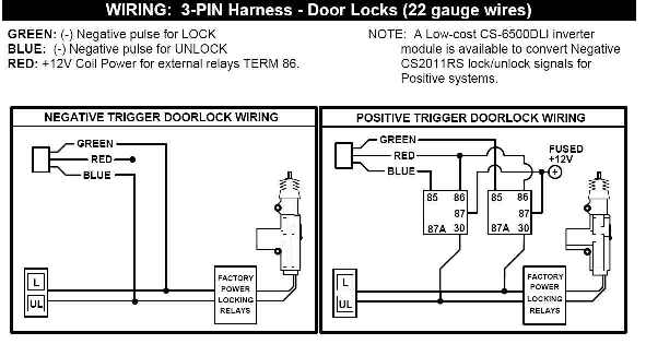

Where are you reading this +12v .75 sec pulse on blue/green trigger wires ?
Crimestoppers come by default with negative pulses on the blue/green wire. It comes with a third red wire along with the blue and green wire which carries 12v to power a relay so you can convert the negative pulses to positive as needed.. Look at the attached diagram..

Never mind. I read the updated rev B manual for RS-2011 IV unit. you should indeed get a 12v pulse on the blue for lock and/or negative pulse on the same wire for unlock. If it does not work, looks like the alarm brain took a wrong turn somewhere. Call up crimestopper support. see if there is a jumper or dipswitch that is a hidden setting that might reset..they'll replace the unit for you if needed. I would try one simple thing..a whole system reset... Try it and post back with results..
