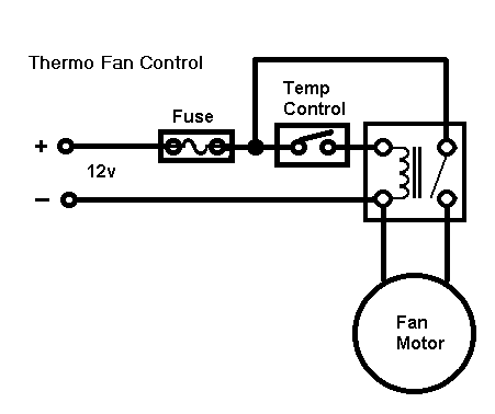

Ok how's it going I've done research but can't seem to get to the bottom. I need help designing a wire diagram to control 1 or 2 fans, using standard 5 spade SPST relays, or a couple of these honda relays.  See diagram below. I'll be using a 2 wire thermoswitch. I appreciate the help. I know a 30amp fuse must be used

How about this one I drew for you.Thermostatic control and fan using relays -- posted image.

Hey man thanks alot ! I really appreciate the time. One question though, is that a normally open or closed thermoswitch? Thanks!

Depends on the Application. I use it to control a Fuel solenoid.
That application is Norm Closed.
For Cooling you need Normally Open so the fan turns on when it reaches the High Limit you set.
How does that look, w/ the exception of the artwork?

That will do it!
