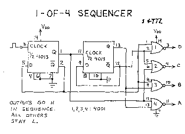

Look at this post! Close to the same as yours.
https://www.the12volt.com/installbay/forum_posts.asp?tid=40671&PN=1&tpn=2
electrical engineer needed - Page 2 - Last Post -- posted image.
Just use a push switch instead of a clock pulse.

Good info. I can just use an up switch and down switch. Did you ever figure out how to make it go back down?If I remove power will it retain memory? If not I can wire my relays using ignition but how much current draw on that circuit? Thanks for the help and keep the ideas coming.

I would probably just use a microcontroller to save the hassle (like a PIC) but that requires the hardware... I could burn a PIC if you want and if i get the time to do so (low on free time lately)

that other bored posted above reminded me of that, there is another chip ment for digital clocks, it's like a pulse counter, you could use that, altho i think it puts out binary, i'm not really sure, but it might work for ya, look something like that up in mouser or something,, or maybe i'll look at get back to ya
