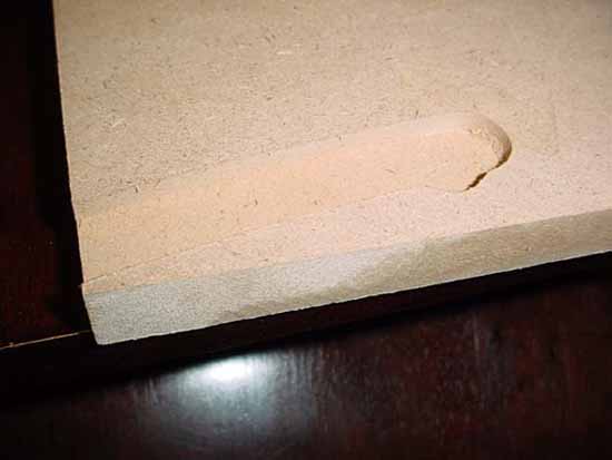

Hey guys and gals,
When using the router, my workpiece moved because I didn't have it clamped down tight enough.  Its a complex piece and I don't want to make another one.  How would you recommend fixing/filling in this slot?
MDF Repair/Fix Mistake -- posted image.
I thought about trying to use milled glass mixed in resin.  What would you guys use?

Oops, sorry about that bad link.  Try this:  The slot is 3/4" wide, and 1/4" deep.  Its in 3/4" MDF.

That slot was supposed to be right along the edge of the wood, as to make a stepped edge.

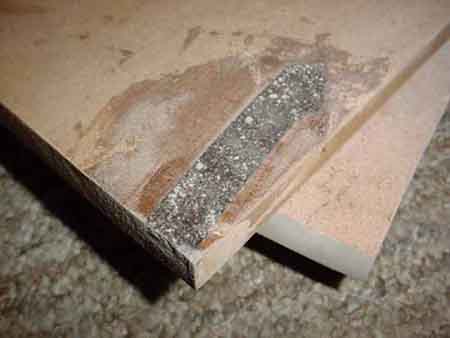

Here is what I did.  I mixed half a cut of resin and MEKP up.  Then I slopped a little bit in the slot to line it with pure resin.  Then I mixed a lot of MDF saw dust/powder into the resin in the cup.  After that I mixed it well and pasted that stuff in there.  Applied heat, waited for it to gel, then took a razor blade and cut it flush.  Then heated it till done.  Here is a pic of what it looks like now.  Should be plenty strong.
