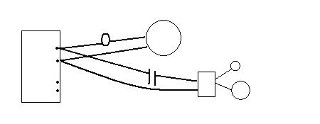

Here is my situation. I want to run 2 sets of speakers off of 2 channels of an amp. They will be a set of seperates and a pair of midbass. Using caps and coils seperating at 250. My problem/question is that the midbass are 3ohm (audiobahn - didn't know but that's what I got), will I drop below 2 ohms or because of the caps/coils at 250 will that keep it at 3.5 ohms? Sorry if this doesn't make much sense but I am posting in the hyperlink area and it is really hard to re-read. Thanks in advance.

As I see what you are doing, you are using caps to block low freqs from reaching the components, and coils to block high freqs from reaching the midbass drivers.  Those caps and coils, used as frequency blockers, won't work the same way as they would when a signal passes through a crossover before it goes to a speaker.  By paralleling the speakers, (and to do that you would have to connect mids and highs separately to the amp), you don't have the benefit of a crossover maintaining the speakers' impedance.
Now, in the case of your components, they have a crossover before the speakers, so each individual tweeter and woofer will maintain their 4 ohm impedance, and you end up with a total 4 ohm load for the component set.
Below is how I picture your setup to look like for one of the channels:  paralleling done at the amp and caps and coils used as blockers to the speakers.
Need help with passive crossover. -- posted image.
You couldn't build a crossover before the speakers, because you would be blocking the highs from reaching the components.  So you end up using frequency blockers, which will not separate frequencies and let the amp maintain the higher impedance.  The two speakers will have their impedances halved at the amp by paralleling, and you will be putting a 1.7 ohm load on the amp.
But I'm not sure about this.  It would be worth putting together and measuring the impedance at the amp.  Let me know what you get.  And somebody who knows better please feel free to set me straight if I don't have this right.

The more I think about it, you should be alright with impedance.  The amp should get the frequency separation.  Should be a 3 ohm impedance to the mids and a 4 ohm to the components, meaning that the mids will get a slightly larger portion of the power.

You hit it on the head, stevdart. I guess I didn't explain myself properly. From my limited knowledge interpretion of what I read in the Acoustic Power and Output section the blockers would/could be acting as a crossover because of the frequency seperation without overlap(I hope). I am assuming that the coils would be using the 3ohm factor. I got 1.9099 and caps @  4ohm got 1.59. I am also planning on using the amps hi-pass crossover @ 100hz. I am running a sub.

What you're doing will work just fine.  You are building a 1st order (6db/octave) crossover.  THIS page might help you out.
