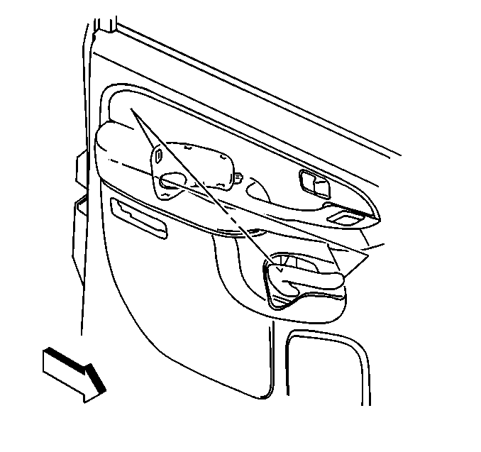

Insert a flat-bladed tool between the door handle bezel and the trim panel in order to release the handle bezel tab retainers.
03 escalade door panel rem -- posted image.
Remove the door handle bezel from the door panel.

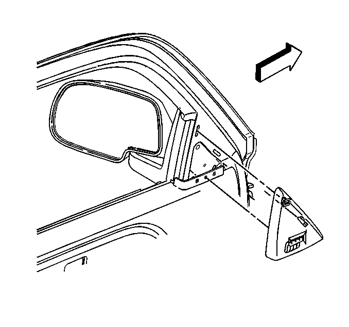

Release the upper extension by pulling outward on the front edge in order to release the upper retainer clips.
Remove the upper extension from the trim panel by lifting up and out.
