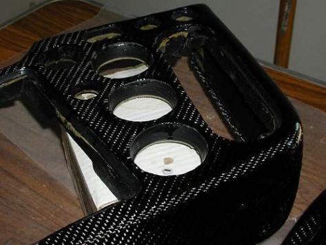

You'd be surprised how well CF will lay around curves and bends, but a lot of it has to do with the weave you use. Two of the most common weaves are the plain weave and twill weave. The plain works well for flat panels and doesn't wrap around things easily. Twill weave on the other hand easily molds around contours because the way the fibers are woven allow it to move easier. I made a carbon fiber overlay of the dash in my Talon with a twill weave. Here are a couple of pics::a few Carbon Fiber questions guys -- posted image.

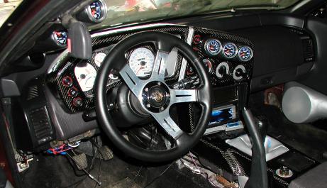

And one of the finished dash in the car::a few Carbon Fiber questions guys -- posted image.

that's cool, that looks really good man, i might try it, the only cf place i know of is select, i can get clear resin anywere, do you know of any other places to get the mat or is select my best bet there?
