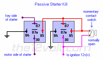

In the diagram below what is the actual connection for Key side of the starter, is this the "S" terminal on the solenoid? Also Motor side of starter is this the connection at the negative side of the solenoid contact disc also known as the "M" terminal, the one that goes into the motor field coil windings?
Thanks!

Well as I see it,
 you would need Different Relay for the first one.
Cube Relays Generaly handle 30 amps max and would Fry.
I think a FORD Starter Solenoid would handle the Current much better.
 The 86 would be the case of the solenoid and the 85 would be the S terminal
30 and 87 would be the Large posts
