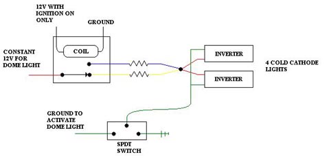

I'm kinda come up with an idea with a relay thats wired in with the ignition. I'll post a diagram of what I'm talking about once I figure out the resistor values.

Here's the diagram.  I haven't thought about the resistor values yet.  I need to find out what the load of the inverters and lights are.
