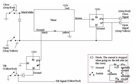

Hi, I setup a circuit using a 528T and a few relays to get my sunroof to have one-touch functionality.
I have experienced problems with the 528T releasing too early, meaning before the time i had set it for.  Sometimes it is the set time and other it is random.
Basically the yellow/brown connectiosn are not held connected long enough.
I will post a diagram.

DEI 528T problems -- posted image.

This is for a Acura TL 03.  Bascially, when the switches are pressed it closes a relay that controls the power or ground to the motor for the direction.  The reason I dont use a 529T is because of the tilt feature.  Using the 529t to the motor will always cause it to tilt.
