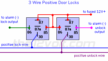

Hi, I'm new to all of this so please forgive me for my lack of knowledge. I saw the diagrams for unlock and lock with  and without an alarm system. I have right now a Code alarm in my 95 Lesabre and I would like it to auto lock and unlock when I start and shut off the car.
Can someone point out the right complete set or relays to wire up and what color wires I would hook them up to?
I guess the best place to put this set of relays is under the dash right?
Thanks...
Oliver

You can start with the diagram below. Ask question if you are stuck on the install.
You can place the relays anywhere you find room. Make it neat and tied it up so that it doesn't interfered with any moving parts underneath the dash.

95 Lasabre door lock/unlock -- posted image.

Thanks for the helpfull and quick responce. I will give it a try.95 Lasabre door lock/unlock -- posted image.
