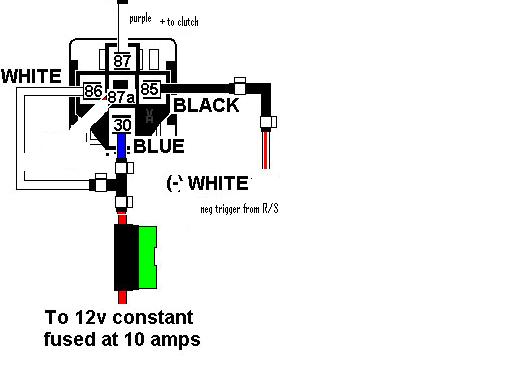

I am also looking for a clutch bypass diagram for a 2000 Pontiac Sunfire, Can anyone Help?

The clutch has two wires on it ( 12-14 guage ) , use the PURPLE wire and have a relay give (+) pulse to it when remote started.

Will This work!
Clutch Bypass for 2000 Pontiac Sunfire -- posted image.

Posted: March 21, 2005 at 1:47 PM / IP Logged
Yes this will work.
