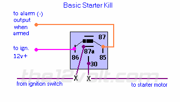

" My system is installed and starts and runs fine, but starter kill does not kill start with key when armed"
You probably didn't setup the starter kill correctly.
Set it up like this.
98 Dodge Ram Wiring Confusion -- posted image.
